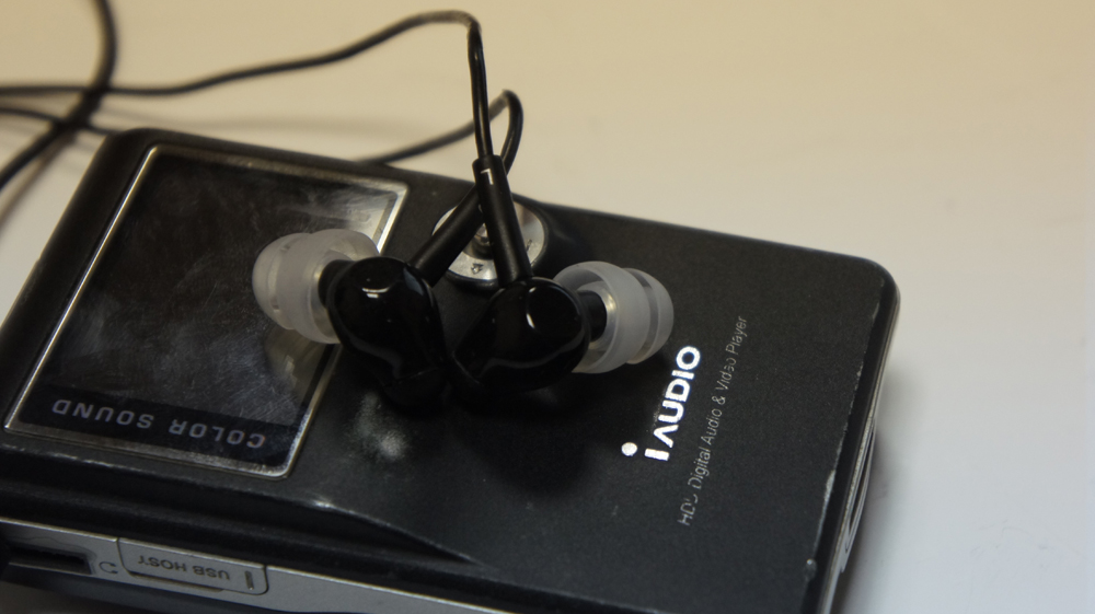

HiFiMan Re262
Сразу, пока не потерял ссылку - небольшой вариант доработки на английском Foam Reposition [Do It at You Own Risk] - [Potentially Warranty Void] The compactness of the foam inside the nozzle plays a crucial role on the final sound. On default, the way it is packed in is dense - good for bass but bad for treble. But if you remove it or repacked it too loosely, treble will shine but bass loses its texture. After several trials and errors, here is a way that I find to give the best balance between bass and treble. The good thing about this mod is that it is reversible. If the final sound is not to your liking, just repack the foam in a dense way. Note: You might want to take a good look at how the foam is packed when you take it out of the nozzle at the first time so it can be packed back in roughly the same way. As I have said early on, this mod is not necessary an upgrade in SQ, but more of a redistribution of energy to achieve a more desirable sound. So my recommendation is, do burn in your IEM first, then consider this mod if you are looking for something slightly different than the result of the burn-in process. ![]() Step 1. Remove the mesh filter and foam. Use a needle to carefully pick against the edge of the mesh filter (between the mesh filter and the nozzle body) should remove the filter without destroying it. The removed mesh filter will be reapplied later on. Use the needle to remove the foam as well. Step 2. Allow the foam to expend, then place it on top of the nozzle. Make sure they are aligned. Step 3. Use a pointy and slim object (but not pointy enough to penetrate the foam) and gently push the center of the foam into the nozzle. Step 4. Push the whole foam into the nozzle, but not too deep to fall into the housing. Step 5. Take the pointy object out and there should be a small hole left in the center as the foam compact around it. Repeat Step 1 to 5 to the other nozzle and listen to them both. Make sure there is no unbalance issue (swap side when listening also help). If unbalance is detected, repeat the process again till it is fixed. Step 6. Place the mesh filter back. The small hole should remain intact and visible. И немного фоток моих уже. По звуку - сегодня - завтра напишу. -------------------- |
