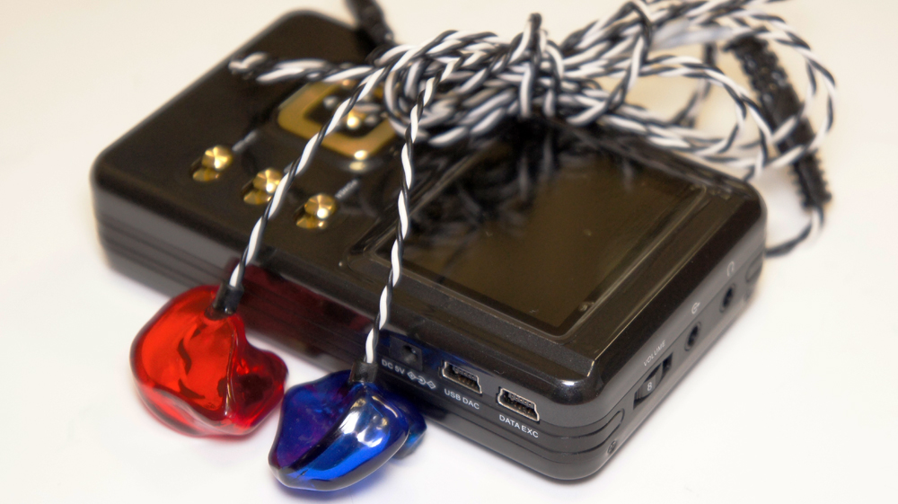

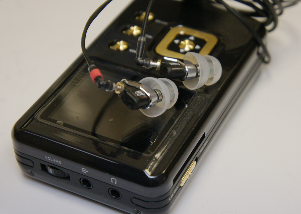

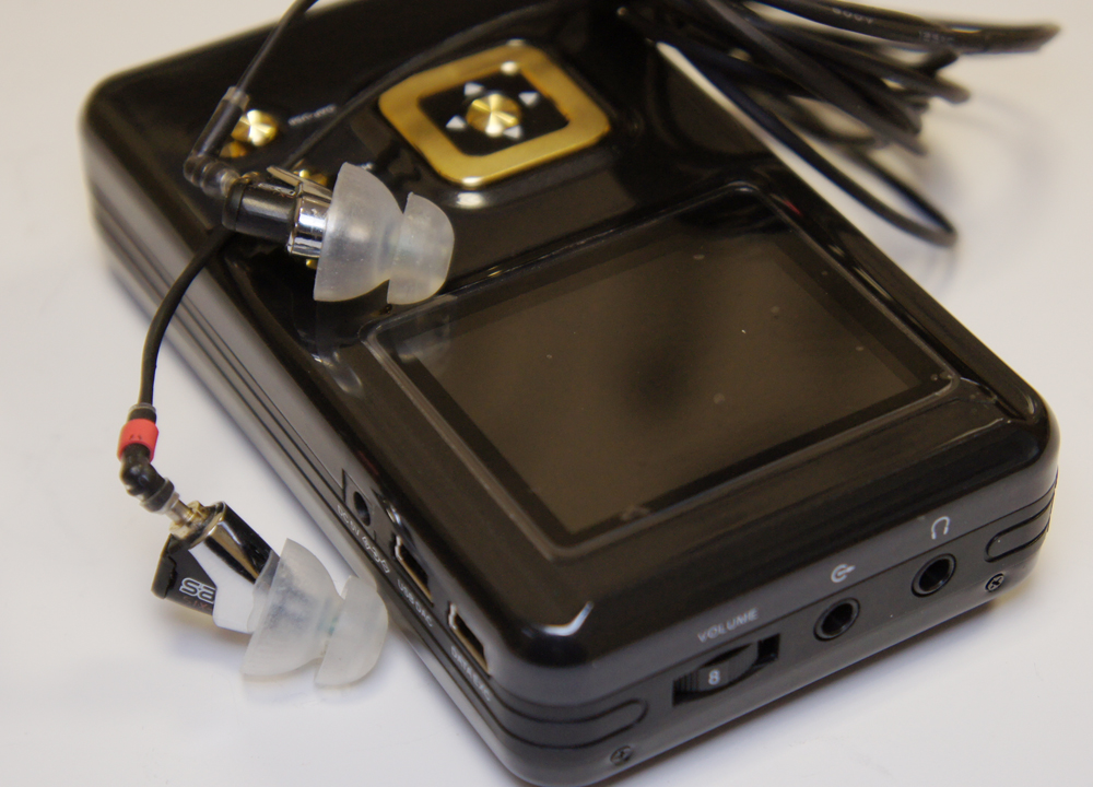

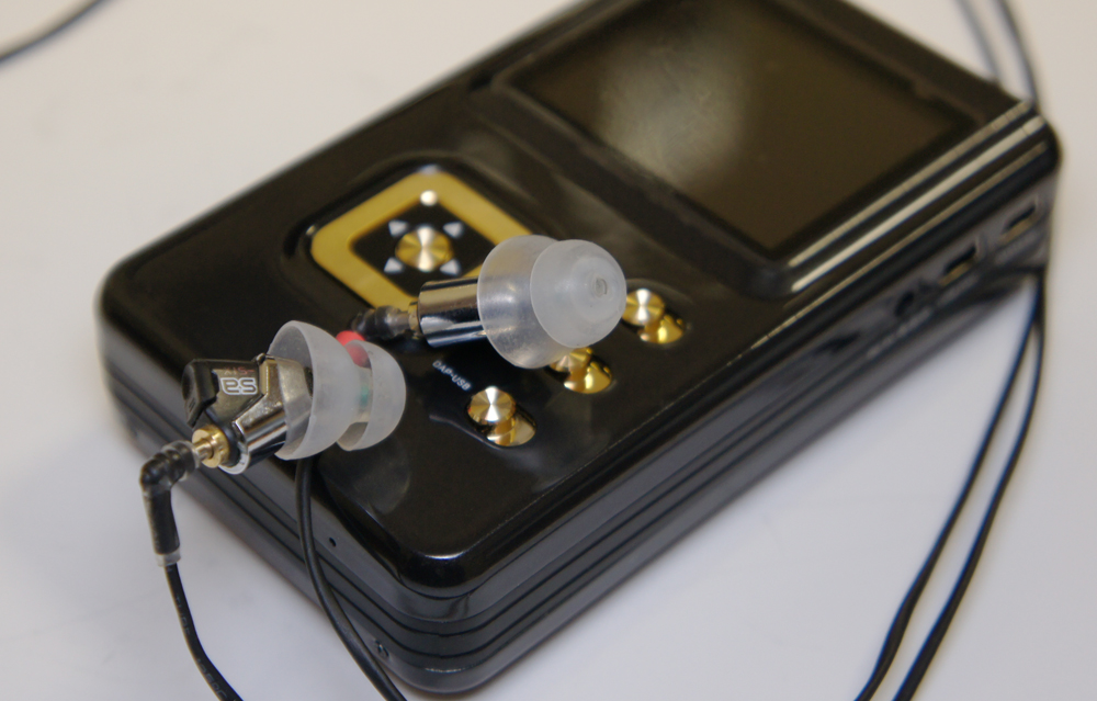

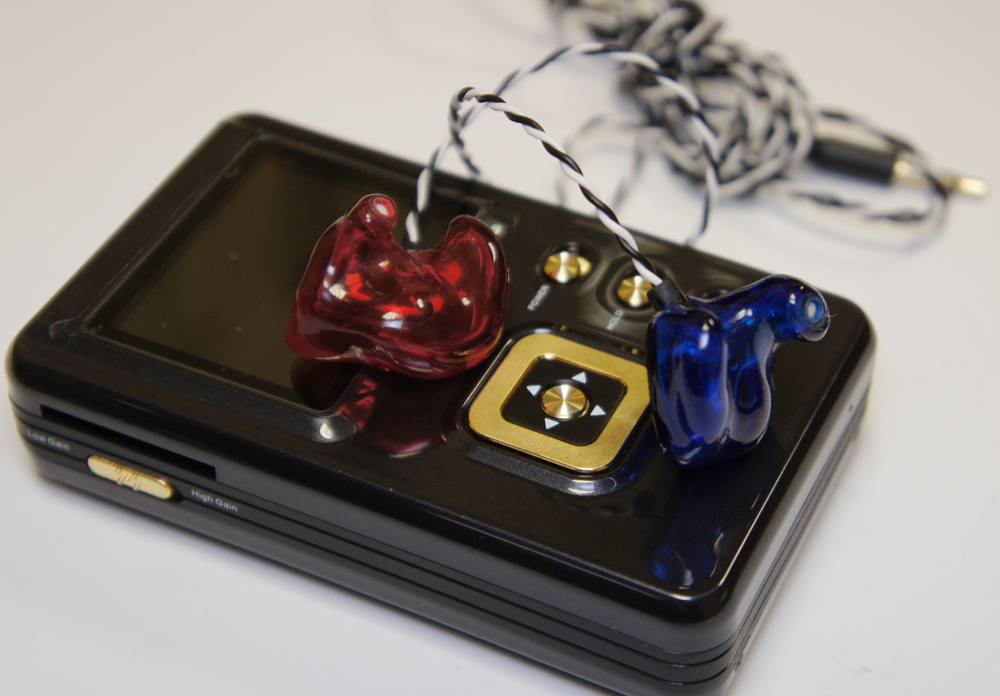

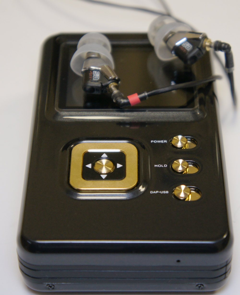

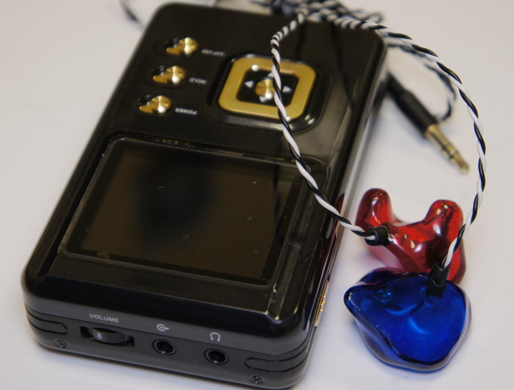

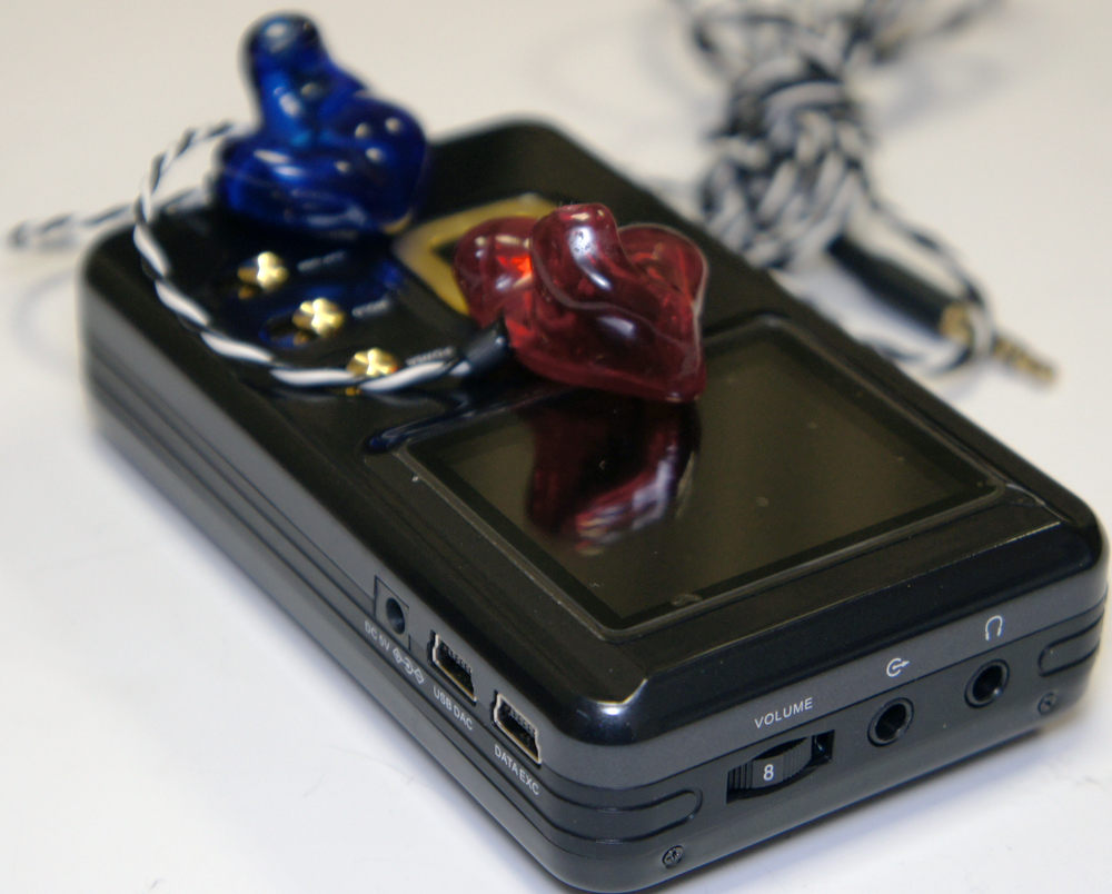

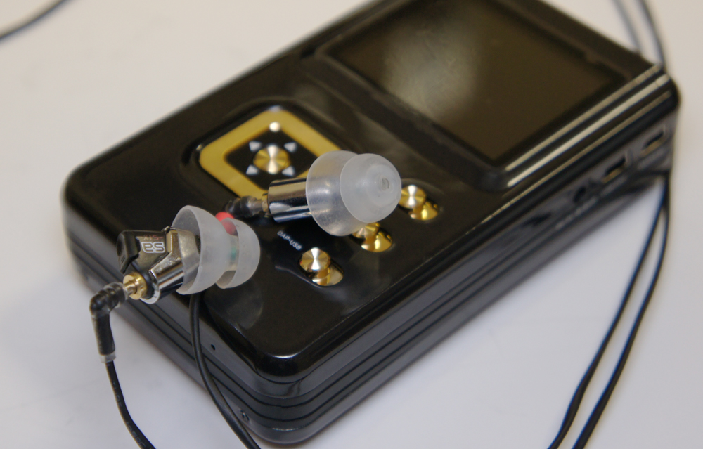

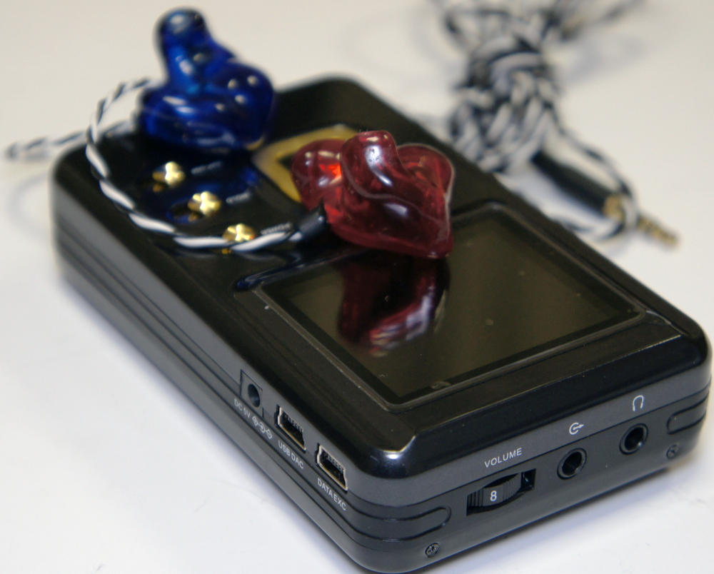

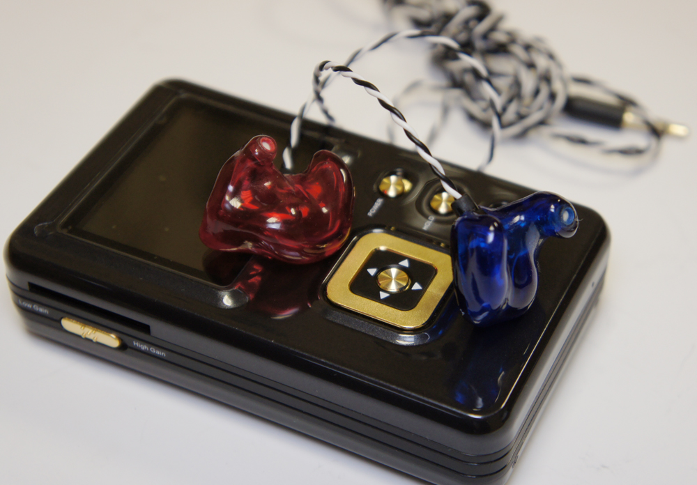

HiFiman HM-602
Приехал...
Немного на иглише:
It is well known that Non-oversampling dacs offer great sound for little money. HM-602 is the first portable player using non-oversampling DAC: Philips TDA-1543. As younger brother of HM-801, HM-602 shares HM-801's great sound signature. To make it as portable as possible, HM-602 do not have amplifier modular design. However, its headphone amp part is very similar to HM-801's standard module. To drive both high impedance and low impedance headphones, HM-602 with the high / low Gain switch can drive both high efficiency IEM and most full size headphones. In addition, HM-602 also can work as a USB DAC.
D/A Chip: TDA1543
LPF Op-amp: OP275, OPA2604
Headphone Amplifier Op-amp: OPA2107
Freqency Response: 20-20K Hz
Distortion: 0.09%
S/N: 92 DB
Stereo crosstalk:74 DB (Lineout)
Headphone Amplifier
Output level: 1.1v at 32 Ohm; 2.2v at 150 Ohm
Max Output: 30mw at 32 Ohm; 26mw at 150 Ohm
Size: 62mm*103mm*26.5mm or 2.4 * 4.05 * 1.04 Inch
Weight: About 200g / 7Oz
On board Flash: 16GB
Battery time: 9 to 10 Hrs
I / O: Headphone Output; Line Output; USB Data Exchange; USB DAC Input; SD card (up to 32GB)
